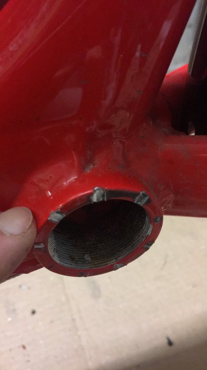

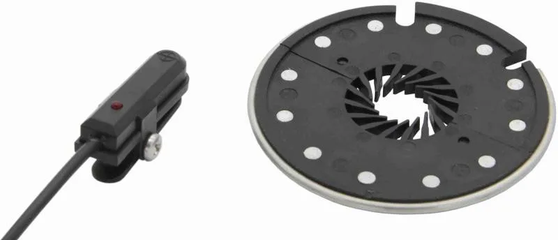

June 25, 20196 yr I agree with Nealh. Show us a picture of your bottom bracket left hand side so that we can see if there is enough space for a PAS disk like this one which requires no disassembly of the crank etc.

June 25, 20196 yr Author BB a standard 68mm one, only got this pic on my mobile now (took it to show a friend the grinding done by the BBSHD I removed). A cadence sensor will be easy enough to fit right now (have a standard shimano setup at the moment) but I’m really leaning towards a belt drive and rear hub (dreaming of a rohloff but can’t afford that). Thanks for the link above. Yep had seen those motors on Aliexpress. So SWX02 better than an MXSUS XF07? Would you guys mind looking at my shopping list, after I come up with one that is? Cheers

June 26, 20196 yr Author BB a standard 68mm one, only got this pic on my mobile now (took it to show a friend the grinding done by the BBSHD I removed). Sorry realised I forgot to upload the pic

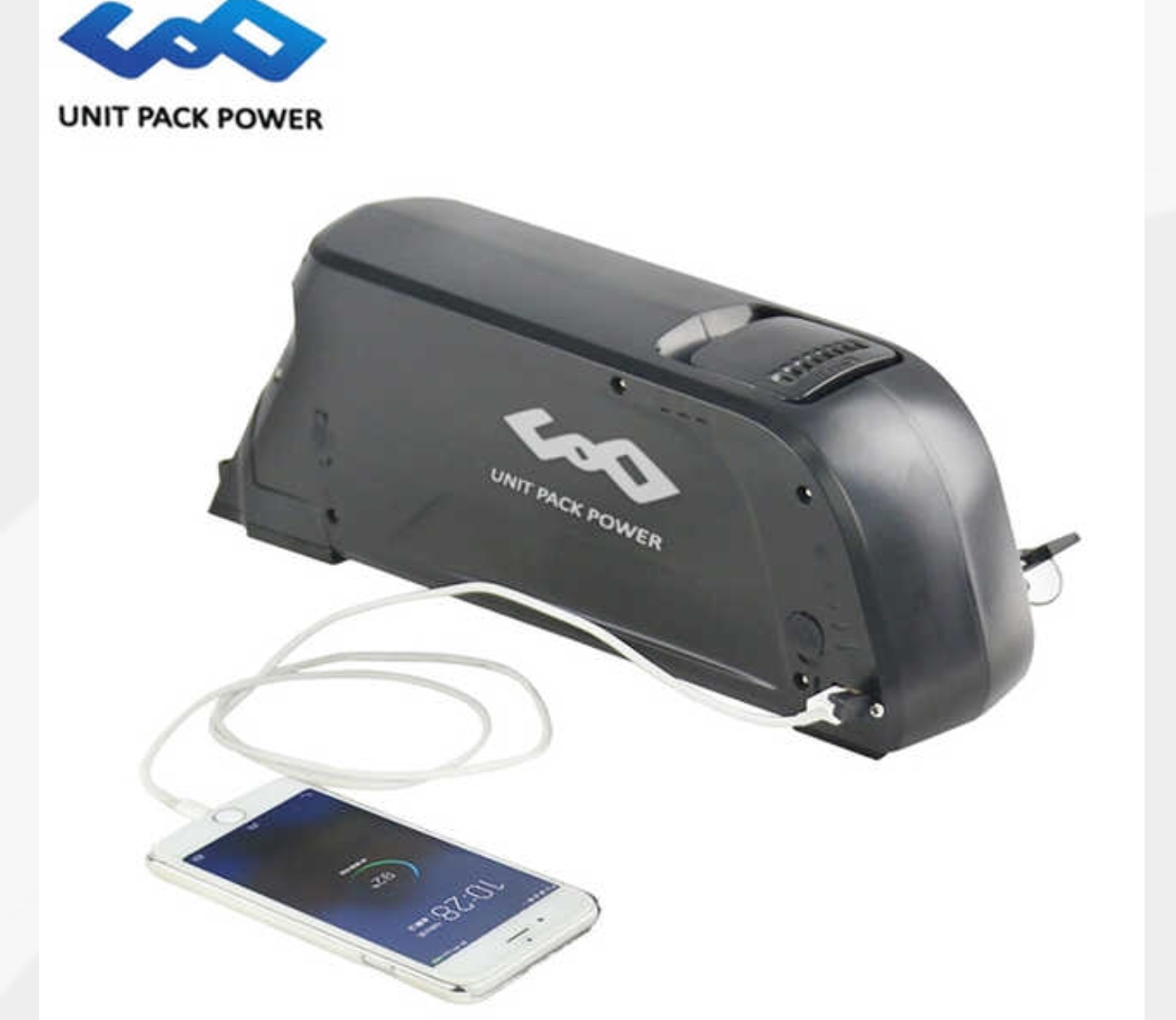

June 27, 20196 yr Seems a no brainer. I do value different opinions, but overall what’s the final verdict? that depends on your battery. Can you post a picture of your battery?
June 27, 20196 yr Author that depends on your battery. Can you post a picture of your battery? It’s a 48v 13.8 Ah built by a friend using Sanyo cells. Will take a pic tonight after work but it’s a dolphin case like this one (pic from the internet):
