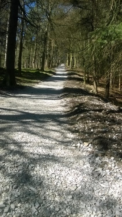

If anyone's familiar with The High Peak Trail in the Peak district then the incline is similar to the beginning/end of the trail at from Cromford up to Middleton Top.

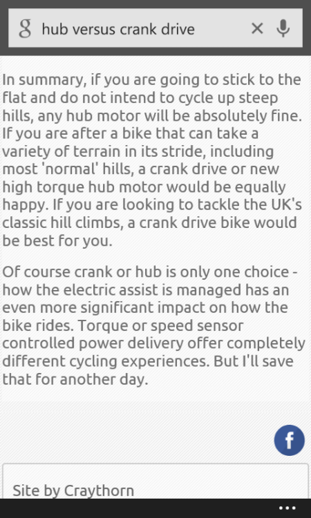

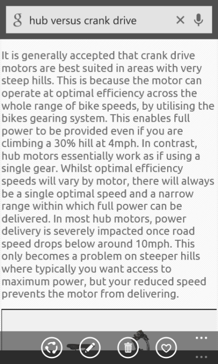

A big high torque hub Ezee etc. or a mid drive WITH the correct gearing.
A cadence detecting mid drive (BBS01) will climb at low speed the hill you describe with no rider input if geared low enough.
